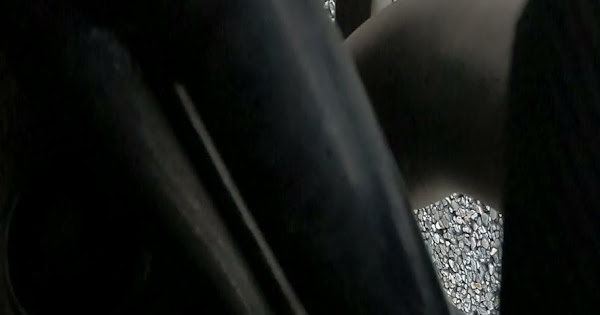

    Started filming again because it is such a pronounced feeling there has to be a possibility to catch it with a GoPro before replacing random things.
    Number 11: These movies (https://photos.app.goo.gl/TpBHstoKKbCBbsNC6 and https://photos.app.goo.gl/Mji9pfnKnhVpZkAz8) are from bushing number 11. I replaced number 10 but was thinking that maybe there could be play in the HSR unit. You can see the working HSR unit and no play. So I can guess I can rule out is?
    Number 16: These movies (https://photos.app.goo.gl/CDru9u99Yj4SiuCk6) are from number 16. There is a little bit of play but doesn’t seem to be the problem I think do you guys agree?
    Number 13: These movies (https://photos.app.goo.gl/tUJisFCdTyCNhWyVA) are from number 13. I don’t thinks there is a lot of play here. The most interesting is that you here the sound the most pronounced in this movie (https://photos.app.goo.gl/dVqj3G8SfLNhkWQc7). The GoPro is attached to number 10 to film number 13.
    Plan for now is film number 15 and number 9 although 9 is new because I replaced number 10.
    Do you guys have any idea where to go from there?
  • Well, not much left it seems… Trouble here is it is hard to determine what abnormal play is when you have no reference what normal play looks like… So much movement is supposed to be there by design on active rear steering (ARS).
    I assume you turned off ASR and there is no clonking sound ?

  • Finally found the problem. It was a complete broken engine mount on the left front side. It felt 100% that it was coming from the back. I thought to share it with you guys maybe somebody else will be helped with the solution.
